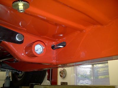

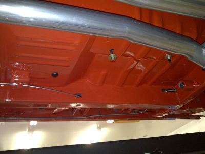

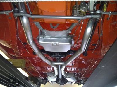

I used the US Car Tool sub frame connectors on my 69 RR convertible. It's a problem running your prebent lines after they're installed...but it's an easy fix.
Here's a pic of the fix...
