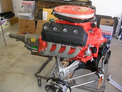

I decided to install an electric fuel pump in the roadrunner this week. I had it around for a few months but am just getting around to it. Here's the issue, the pump has 3/8" nipples and the fuel line is 5/16". This kind of irks me because I ordered a 3/8" line when I put in the hemi but sent it back because I thought it was the same size as whats in the car now. In fact I swear I miked it before I sent it back. I split the 5/16" tubing I tried to install first so I went with 3/8" tubing and double clamped the small sides. I am not comfortable with this arrangement so I'm thinking I will install 3/8' fuel line after buying it again.
Here's the question, I seems the fuel sending unit comes with both a 3/8" outlet and a 1/4" return. If I install a 1/4" return line, how does it hook up in the engine compartment? A vapor separator?

You would need a vapor separator or a fuel filter with a return. The vapor separator is the black canister in front of the fuel pump, it has an in, an out, and a return, that is metered by its size, It also is the only filter on a hemi car other than the gas tank sock. I will look for the fuel filter part number if you want to go that route. The 5/16 version is Purolator F21117 I would have to dig into my jeeps for the 3/8 #, Not enough time right now but I'll get it .

A fuel filter off a early 80's v8 pickup truck has the right filter that you are looking for. Thinking of adding a return line myself and that's what I found would work. Hope this helps.
