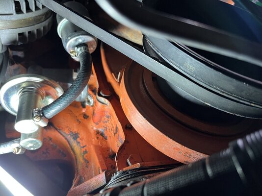

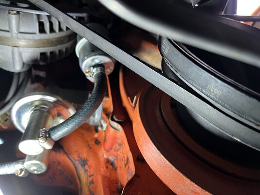

Kept thinking that the reason for the oil pan gasket area all the way around showing wet was possibly a bad install on the gaskets. But the fuel pump gasket and bolt underneath it were found be leaking and that fuel was wetting the whole contact area of the gaskets and pan. Gotta take it out for a cruise and then take a peek at and see if all is dry .
turn in the fuel pump rod plug in further it hits the bottom of the pump and wont seat
