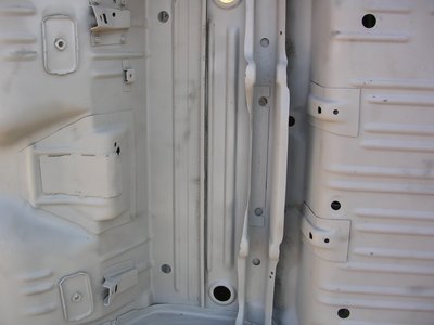

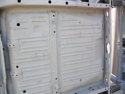

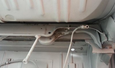

Another problem, the guy I purchased the car from changed the trunk floor and in doing so cut out the shock absorber housing and just welded the old one back in. He also took a couple of long thread rod and just welded it to the housing to hook up the fuel tank. (See Photo) So I am in the process of welding the new housing in place and have no idea where the J-bolts go. Does anyone have a photo showing the J-bolts location. Also what is the diameter of the J-bolt I think the old owner may have reamed out the tank straps to a larger sized so his thread rod would fit.

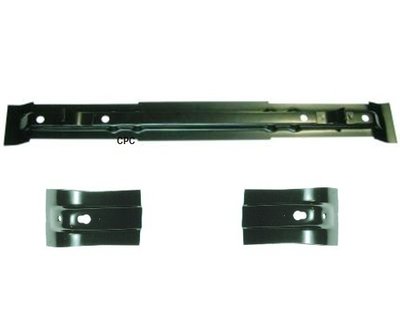

after looking up I need the trunk floor brace set, do you also have a picture where the other bracket goes.

thanks so I have that one, they just did not put in the j bolt holders, nice, can't find anyone who just sells those pieces.
You have them pictured here, where did you get the pic from?

finally found them on ebay, it's almost cheaper buying the set and then put the other brace back up for sale. Found picture on ebay, TAMAZ is the seller
gawd don't you love previous owners....... :facepalm:
