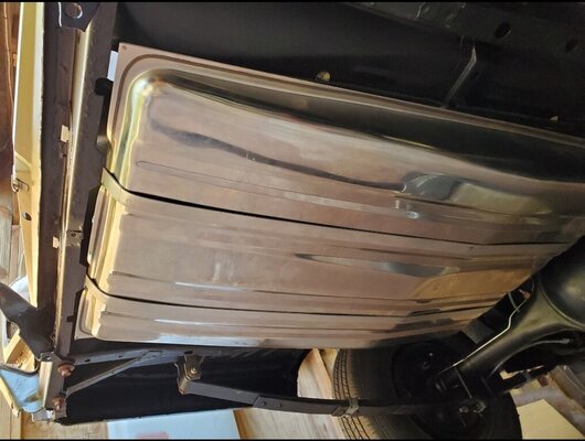

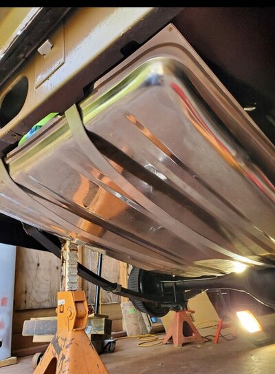

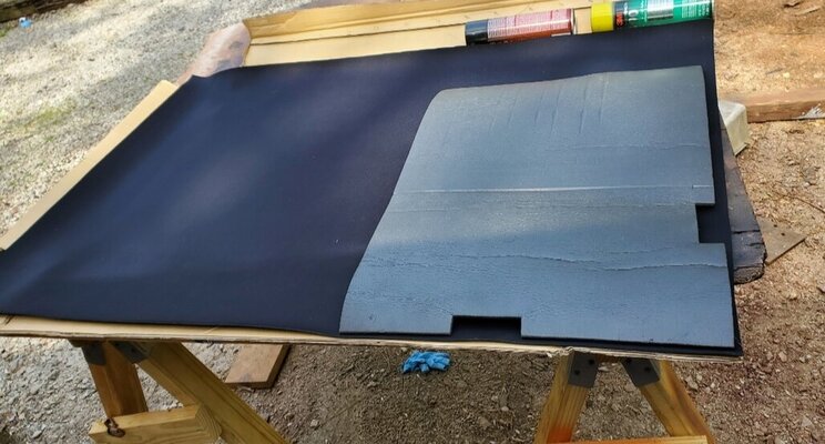

Bought a stainless tank, stainless pick up and stainless straps all from the same place a few years ago.
Decided to upgrade from the standard "roof felt" pad and got the "rubber" one.
Started to put everything in this week and found the "rubber" pad is waste of money.
It's skimpy and the "die cuts" are not in the correct location. (Like that matters.)
Barely covers anything.

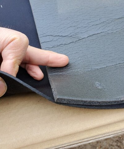

So after actually trying the worthless "pad" from our friendly west coast supplier , I went to the local Home Depot, Lowes and Hobby Lobby on a recon mission yesterday.
Nothing I wanted to use.
But once again, Joann's Fabric saved the day.
Found neoprene "wet suit" material.
One yard, doubled it and had some left over.
(And no cancer warning.)
It's not very stretchy and has enough squish.
Those stainless straps are tough.

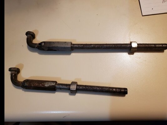

Ever had the problem of not having enough threads to get the J hooks started??
I made some tools to pull it up. (Use a jack to help.) And use as much "all thread" as needed.
I just got what I'm going to use for the roof insulation too.
I know everyone has what they want to use.
My thoughts were that I wanted something light weight.
So that ruled out all the butyl/tin foil products.
(Kilmat is a good choice for the floor. I've used it before. Cheaper than the other stuff. )
I've actually got some http://www.carinsulation.com/ stuff.
But that seemed inadequate IF there was a better choice.
Joann has a "densified poly foam" for a cheap try.
Money wasn't an issue. I'll be putting the head liner in myself.
(How hard could it B ?)
