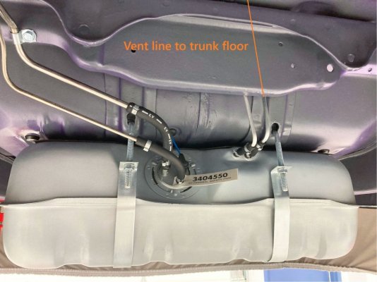

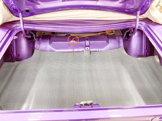

Hello Mopar fam. I’m working on a 70 Roadrunner. The trunk floor was replaced decades ago when you could only get a 2 piece. The only hole in the floor is for the sending unit wire. I’m installing a new tank with the 2 vent lines. Can someone with a 70 take some pics of the vent coming through the floor in the trunk and possibly get some measurements so I can drill holes in the correct locations. I have the 70 service manual with a diagram but it doesn’t show location. Thanks.
See the two attached. The replacement trunk pans should have flats that indicate where the holes go for the grommets. The other holes around the grommet on the passenger side are hole plugs.
