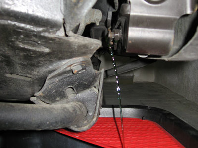

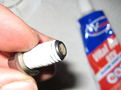

If the antifreeze is leaking from your headder screws like this:
you need this:
Here some pictures from what I´ve done....

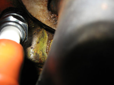

On this picture you can see the problem with the green coolant coming from the header screw hole...running around my sparkplug all the way down to the oil pan.

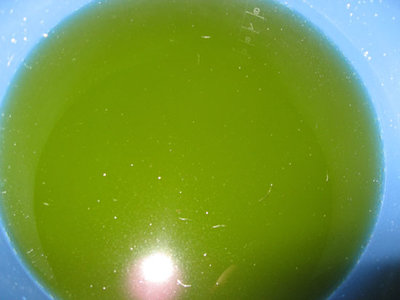

I drained the coolant...
I was suprised how clear the coolant is looking ! You can even see the bottom of the bucket !!!! Looks great !

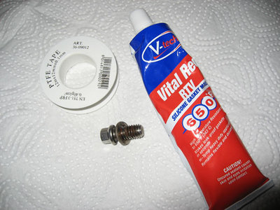

this is what I used - RTV and something we call Teflonband in Germany.
I wrapped the Teflon around the bolt...

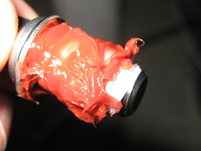

Put the RTV around...
screw it in .... DONE !
Don´t forget to refill the coolant ! :yesnod:
