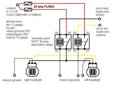

Daniel stern lighting has a lot of good info on his website on how to upgrade headlights with relays etc. will post a picture on how I did mine tomorrow.

night and day.....no more dimming of your headlites while idling......your headlites will be nice and bright....there will be one relay for low beam and one relay for high beam....if you look at diagram it shows you that....very simple hook up

Thanks for the info Quickbird. The Daniel Stern site explaines it so even I can understand it.
I don't expect to be doing too much night driving, but I bookmarked the site and will keep it in mind as a future upgrade if needed. I appreciate the great advice. :worship:
