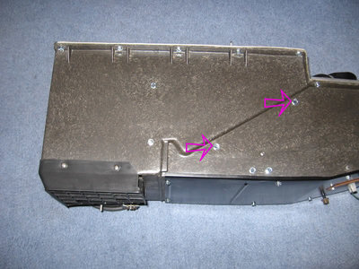

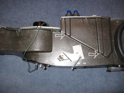

just for reference you will need to remove the heater box and then remove this panel:
and then the heater core can be removed after removing these 4 screws.

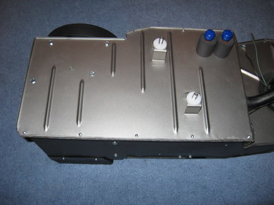

Awesome pics Mac. It would be nice if my heater box looked like your's. All new and stuff. It look's like there is 2 bolt's on the firewall side and a metal strap on the front side that hold's it in place. Am I missing anything else that will hold it from coming down ? :cheers:

there is a total of 3 studs that go through the firewall along with the support strap.
