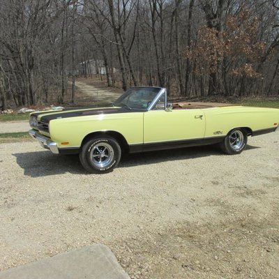

Thanks. I have everything now except the 2nd Y2. Could that be for a white top?
Now to show my computer expertise. Tried to insert a picture with "insert image" didn't work. How can I get a picture inserted?

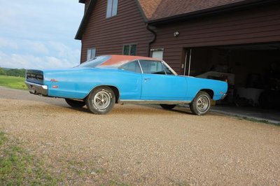

here is a pic of an factory Big C 003.jpgV top car. note no paint on roof. just over spray around the top. Lynch Rd car. one of my St. Louis R/T's also a vinyl top was the same.
