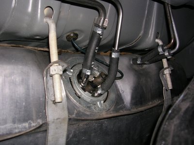

My tech is concerned with where to install the vapor return line at the tank? His concern is that if we cut into the vent tubes, he's saying that it will be liquid fuel traveling back to the tank, not vapor and may leak from the existing vent tubes? Thoughts on how to install the return line?

You should have 2 vents at the tank, I would use the short one that was leaking but just use it don't T into it. Unless you have a 3/8" pick up, it would have the return on it like the one below.
