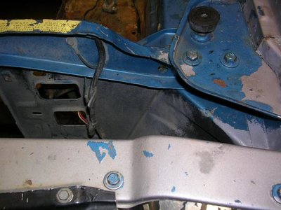

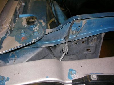

Thank you quickbird, the radiator core ground is clean. When I replaced the battery a few months ago I cleaned up the ground contact and terminal to like new. The terminal is in great shape with zero corrosion. While searching websites I have seen another ground closer to the head light sockets. Is there an additional ground in that harness I am not seeing on mine? Just looked at the Daniel Stern website you mentioned. There is a lot of good stuff there to research. Thanks for the reference.

there is one on each side see the hex head screw on the single wire

69hemibeep, I do not remember seeing one on the passenger side. With the help of your pictures I will track down where it is. Thank you very much for the visual help.

I found the problem while going around with a long ground wire to see if I could find the bad ground point. By chance while the car was running, I touched the core support body ground bolt which was too hot to leave my finger on for more than a second. The ground pad on the weld nut was clean which caused my attention to go elsewhere, but when I poked around it, the paint cracked where the nut met the core support. The nut/ground pad was not making good contact to the core support. I do not have a welder so I replaced the bolt with a longer one that protruded the core support by 1/2". Cleaned the paint from a spot on the front of the support for a ground contact point, put a flat washer and nut on then pulled the ground nut/pad back flat with the support. Cool as a cucumber and the brights are bright. The bolt was pretty darn warm on just battery but would get extremely hot when running. I would like to thank everyone who helped focus me on the grounding issue instead of the dimmer switch. I appreciate the help.
