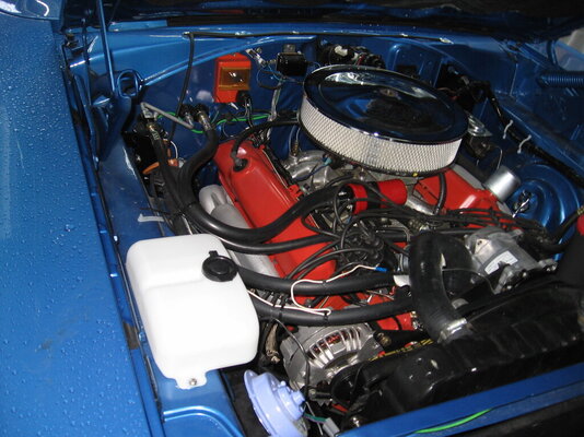

On my 69 they keep the hood from rubbing the fender's. See it on the left behind the water bottle. Hope this will help.
WWheeler
Mar 7, 2019
155
115
Have you actually seen that they touch the hood when it is shut or just assume it does? I assumed and was wrong. I have the engine and subframe out and can clearly see the clearance from below when the hood is shut.
Engine bay looks great BTW.
