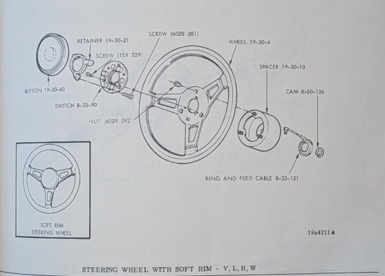

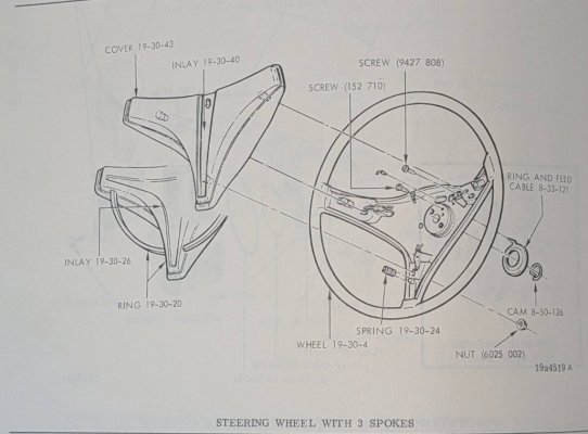

Is there a diagram or instructions showing the correct way to install all the components in a '74 steering wheel horn? The car came with a different steering wheel and inoperative horn and I would like to install the old steering wheel.. I think I have all the parts, I just don't know the sequence they're supposed to be installed.

Three spoke steering wheel:
NOTE: The "ring and feed cable" is for connecting the ground wire for the horn.
Tuff steering wheel:

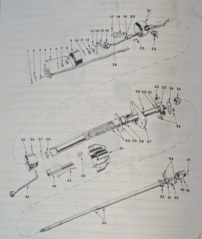

Steering column for added reference:
