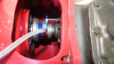

Just installed one. Haven't put the engine and tranny back in car yet so can't tell how it works yet. As for why, because the darn z bar never aligned or worked correctly and I am tired of screwing with it

here is a picture of the hydraulic throw out I installed:

Thanks for the video Big John. Made me laugh. The reason why I ask is ease of driving it in traffic and no issues with the z bar.

keeping fingers crossed, I should be able to answer that question in about two weeks. As soon as I get the car rewired I should be able to give it a test drive and will report back.

I bet you its better than the stock one- it self adjusts ,and I am a super hard on clutchs on my hemi car ,I ran slicks on it and the clutch was the weak link!i broke lots of rods and wore out the z-bar bushings in no time!attachment.jpg
