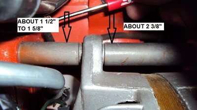

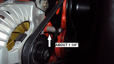

I need the measurements for the two altenator spacers.
The one between the altenator and head and the spacer between the adjustment strap and waterpump.
This is for my 383 and I would think the 440 is the same not sure about the hemi?
It was kinda hard to get in there... lengths are approximate.... here ya go....
:thumbsup:
Craig,
I measured mine and after I looked at the Hoffmans you posted and I had the top/bottum switched and then I measured mine and came up with : :thumbsup:
Top-Matched yours at 15/8" :thumbsup:
Bottum-you 11/4"- me-11/8" :thumbsup:
So I guess they are close and I will tell when I put the belt on and fire it up and they stay on :lol: :cheers:
Thanks for taking the time to measure :thumbsup:
