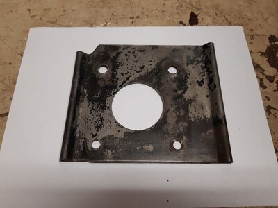

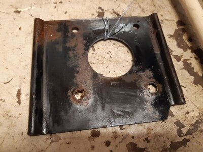

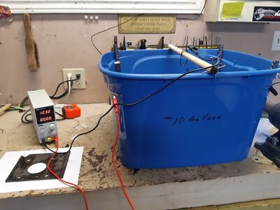

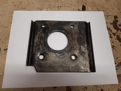

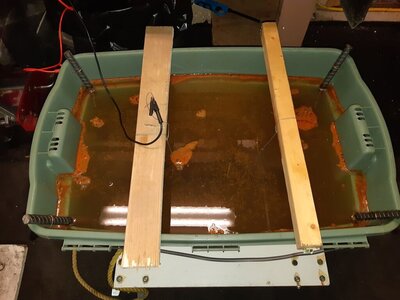

Now that we are in the dead of winter up here with the car in storage, I needed to do something to pass the time. Got a lot of parts for the car in the shed and I'm stating to clean up some for paint. Trying out rust removal with a little science. Takes a while, but interesting results. Here's the link on how this all works .That's the backing plate for the brake booster. Will try other parts and fine tune the process. If you use a battery charger, it has to be a older one that doesn't need to recognize that a battery is hooked up. What is the proper paint and color for the black parts on the car. Thanks. a20210108_1026139.jpg a202101077_125409 (2).jpg a20210107_125453 (2) (1).jpg a20210108_0927599.jpg a20210108_0928079.jpg a20210108_092815.jpg

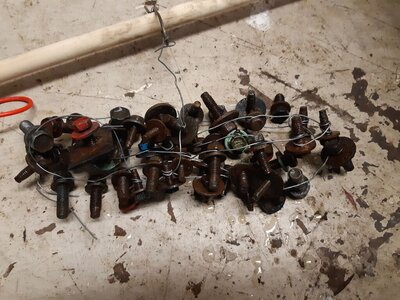

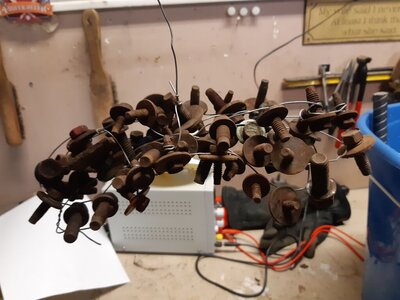

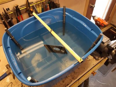

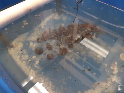

Thanks for the replies. Tried doing bolts this time. Didn't turn out that great. If the bolts are greasy, it just doesn't get into the crevasses and threads. Probably needs to soak in carb cleaner first, but that just stretches the whole process longer than I want. Got a bunch of other bolts soaking for the past week in carb cleaner. Will go the mechanical method with these (aka wire wheel on a grinder). FYI started the process yesterday around noon and took them out this morning. A20210108_140426.jpg A20210108_141659.jpg A20210109_082250.jpg

I tried briefly, soaking parts in different concoctions, after days of soaking I still had to wire brush them off.
On all parts I ether wire brushed, grinder, cut out and re-welded with seam sealer or places where I could not reach, a 3M spray extension on "Eastwood" rust converter . I did this on areas between body and body frame areas.

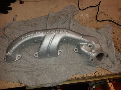

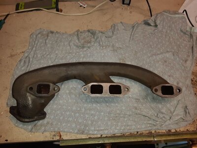

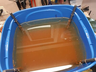

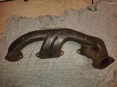

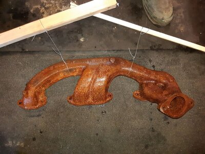

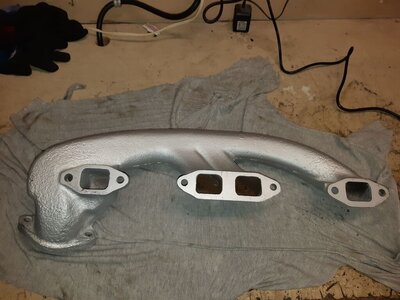

Got bored again. Quite easy nowadays. Got a extra pair of HP exhaust that I wanted to clean up and sell. Since I have time on my hands, well, why not!!!!!A20210118_160351.jpg A20210118_160351.jpg A20210118_183124.jpg A20210118_160351.jpg A20210118_183124.jpg a20210119_124958.jpg a20210119_125018.jpg a20210119_190031.jpg a20210119_190050.jpg a20210119_190453.jpg
7,813
3,391
Pretty cool. Used the zinc process to coat some part's and used a bath with the batterie charger to do it. Did a sand blast to clean the headers I have. They did turn out good. like yours. All ways open to new ideas. :thumbsup2:
