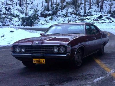

Had the same problem in my old fairlane. Didnt have the patience to go through electrical gremlins, so I just pulled the globes.IMG_71463872230978.jpeg
