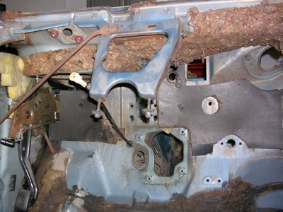

I wanted to follow up on this for someone in the future having the same issue. I replaced the wiper seals and it still leaked. Had a buddy check under the dash and it was pouring in throughout the windshield seal. We took out the windshield (of course it broke) and I had a chance to repaint my dash etc. I am going to silicone the heck out of it around the seal. I will let you all know if it works.
