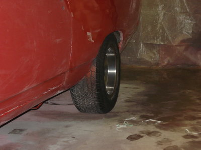

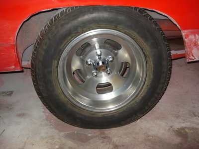

And now, I think it's finally figured out!!!!! From postings on here, to tires with impact breaks,
to buying bum rims at Carlisle, the outcome is finally in sight. Put on one of the wheels last
night at the shop.
You guys were right. It was close with the 15x8.5 with 3.5 backspace. My old 255's made it.
If I bumped up to 275/60 it would have been a no go. Thanks guys. Here are some initial pics.
A little on the dusty side but I could give a s@#$ right now. They fit!
