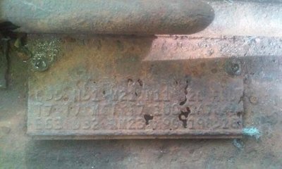

Jan 24, 2016 #1 SgtLee511 Well-Known Member Joined Jul 5, 2015 Messages 506 Reaction score 12 Location Piney Woods of East Texas Fender Tag, Puzzle can you decipher....? Last edited: Jan 24, 2016

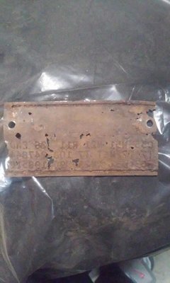

Jan 24, 2016 #2 SgtLee511 Well-Known Member Joined Jul 5, 2015 Messages 506 Reaction score 12 Location Piney Woods of East Texas Second Pic a better clue
Jan 24, 2016 #3 Ranger Well-Known Member Joined Dec 25, 2014 Messages 1,462 Reaction score 250 Location Woodstock ll Might be clearer if you made a rubbing of it.
Jan 24, 2016 #4 SgtLee511 Well-Known Member Joined Jul 5, 2015 Messages 506 Reaction score 12 Location Piney Woods of East Texas I tried but so much rust, Ill try again
Jan 25, 2016 #5 69hemibeep Sponge Bob Square Wheels Joined Sep 10, 2008 Messages 22,348 Reaction score 2,575 Location AZ Desert, Without trying very hard I see its a bronze 2dr hard top
Jan 25, 2016 #6 69Hurstsc Well-Known Member Joined Apr 24, 2014 Messages 220 Reaction score 18 E63 D32 RM23 H9G 198518 (confirm last 6 with VIN) T7 T7 M6T T7 ??? ?????? C55 Bucket Seats H51 Air Conditioning M21 Roof Drip Rail Moldings R11 AM Radio (2 Watts) 26 Radiator End
