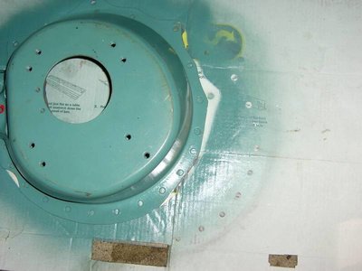

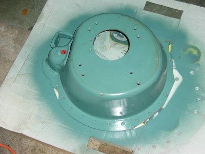

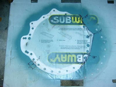

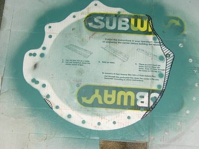

Here are some pics I took that show what must be done to fit a Lakewood safety bellhousing for use on a 383 with tti 1-7/8" headers. The same mods would most likely be necessary using tti's 1-3/4" headers as well. I sent these pics to Lakewood upon their request but never heard anything back from them so I don't know if they ever made this information public. If any of you guys are contemplating running a Lakewood bellhousing and tti headers you'll need this info.
Lucky for me I painted the bellhousing on this large piece of cardboard before I attempted to intstall it. You can see the amount of material that needs to be trimmed away for a proper fit.
