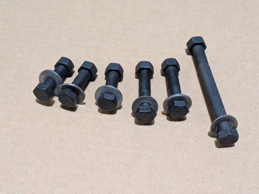

The engine bracket bolt/washer/nut is the same for the 440 as other Chrysler big block wedge engines. Engines through 1973 that used the separate bracket and insulator used one style, and 1973 - 1978 engines with spool mounts that integrated the bracket and insulator in an insert used a different style.
The bracket/insulator style mount uses bolts/washer/nuts as follows:
  • Bolts and nuts are 7/16"-20 thread.
  • Bolts and nuts are 5/8" hex, although some 11/16" hex nuts might be found.
  • Nuts are center lock style.
  • Washers are thin steel, ~11/16" - 3/4" outer diameter. The washers are placed against the block areas.
  • Bolt lengths are:
    • Two 2"
    • Three 1.5"
    • One 4.5"
    • NOTE: Trucks and some early cars did not use the long 4.5" bolt used with the 1966 - 1972 tube style bracket (for dipstick mount). In this case, an additional 1.5" bolt is used. Big block A-body left mount and pre-1966 C-body left mount mounted with additional bosses cast into the front of the block.
The following image shows the bracket/insulator mount style bolts/washers/nuts:

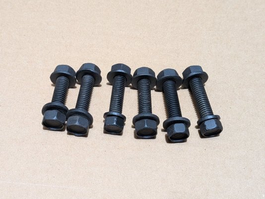

The spool style mount uses bolts/washer/nuts as follows:
  • Bolts and nuts are 7/16"-14 thread.
  • Bolts are 5/8" hex, with captive washers.
  • Nuts are 11/16" hex, flanged, and a prevailing torque lock style.
  • Bolt lengths are:
    • Five 1.625"
    • One 1.5"
    • NOTE: In some cases, a second 1.5" bolt might be substituted for a 1.625" bolt.
The following image shows the spool mount style bolts/nuts:
The two bolt/washer/nut types can be interchanged between the bracket or spool type mounts, except for the long 4.5" bolt.
