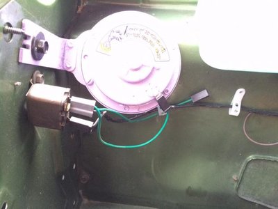

Can anybody identify the wires in the attached photo around the horn area. One connector isn't attached to anything. Just wondering whether it should be?

That's the same on my 69RR. I thing it's for another horn
22,251
2,495
That is the way it should be. The models that share the road runner platform all have two horns
