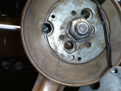

Is that just the cam kit or do I need a new stalk? There was a ton of play and then it just layed flacid (viagra?)... I was going to a show and my right blinker was on for 40 min like an old lady lol
If the stalk is just loose, and the fastening screw is still in place, you can pull the horn ring and pad off and get to the screw through the access hole in the steering wheel. If the screw is gone, figure on pulling the wheel to find the screw. If the screw is tight, and the stalk is still loose, the switch is broken.
