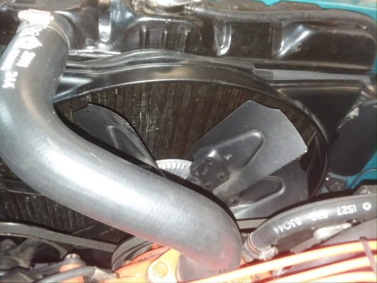

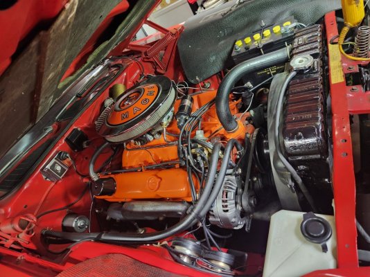

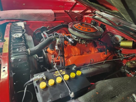

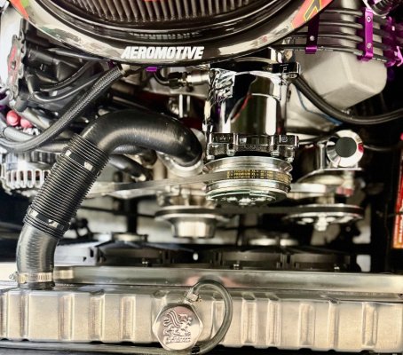

Not a B body, but i have a 22" radiator with shroud in my red 70 E Body if this helps at all. This is about the best pictures I have of the shroud

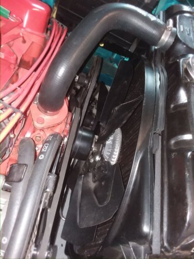

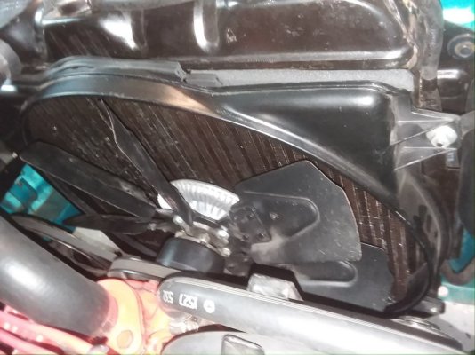

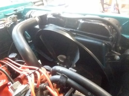

I just happened to have some pictures of my radiator and shroud from when I was trialing different fans. I also took rough measurements of the radiator. It measures 24" from the bottom tank to the top tank (not including the neck). The top tank is 22 1/2" wide, not including brackets. However, this rad has been recored twice, and the current core appears to be slightly
taller than the original, but not enough to affect installation.
FYI, the radiator part# is 2949053
Radiator shroud: 2949130
Hope this helps.
