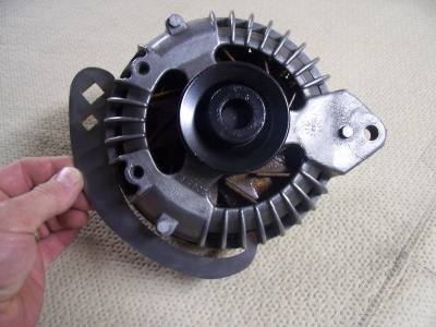

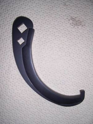

Ladies and gentlemen, fellow car enthusiasts, I finally have the proto type in my hands! I set out on a quest to reproduce the hook shaped alternator belt adjusting tool that hooks into the fin of the alternator just like the factory service manual shows, only with an improvement! How many of us out here have used a pry bar only to end up pinching the heater hose and causing the hose to leak? I know I have at least on one occasion. I tried to find this tool at many parts stores and swap meets and since it seems to be geared more towards only Mopars, I had to end up purchasing one from a friend who was a mechanic. Going off of this tool, I was thinking about how many people carried a half inch drive set in their tool box. From asking people at cruise nights and car shows, the answer was not many. When making this tool I incorporated not only the 1/2" drive size like originally was there but also integrated a 3/8" drive size in case one would need to use this tool on the side of the road with their tool kit in the car.

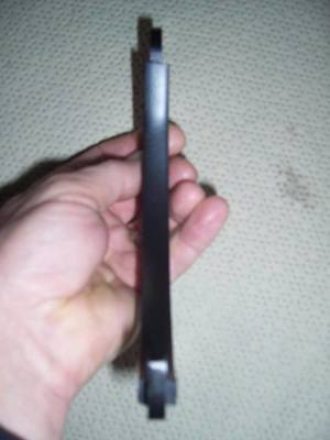

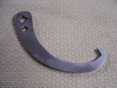

Waterjet or flame cut? I can't see the edges well enough to decide how it was cut.

To be honest, I don't know. A good friend of mine had a contact who was able to make this up for me. I could double check with them how it was cut out. I will say that it is a nice solid piece of metal. 1/4" thick!

The waterjet leaves a nicer finish and usually about the same price as flame cut. Flame cut also hardens the edge, making it hard to do any modification (like with a bandsaw) to the piece. I have had 1" steel cut with waterjet and even have a 3" thick granite surface plate that I had cut in half.
If you need a waterjet shop, I have a friend that owns a nice shop in Syracuse. He's a car guy too.
