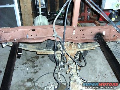

the right stuff is good and they fit right on the car buy s steel lines also got disc brake assy car stops like no OEM disc brakes did and they are cheap--500 for the front assy rt/lt side winter time.jpggot the runners inside and for the winter AL
