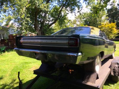

Its the photo, the top is a medium green color.

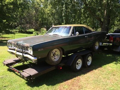

Even if I do use some parts to finish up my 69, what's left will be an awesome start for a project. The body and floors are in excellent shape. The trim is pristine as well. I need some trim, wipers, front bench (way better than the one I have), wheels, third-member is a new 742 w/4.10s, and misc pieces.
that definitely looks like a great project. even if your bench you're replacing is shredded, stick it in the other car.
glad you get it loaded ok.
