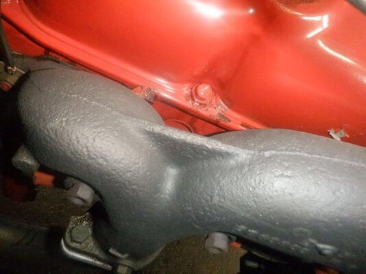

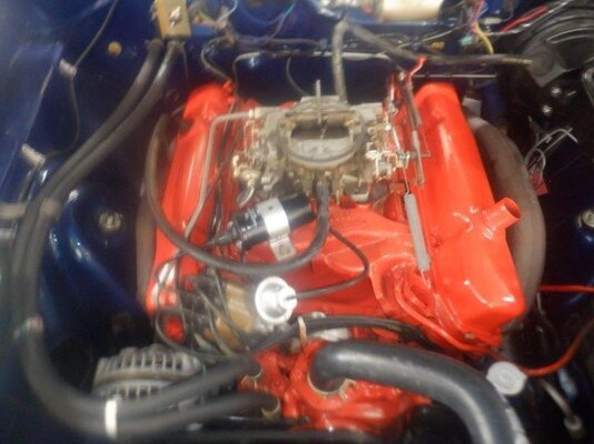

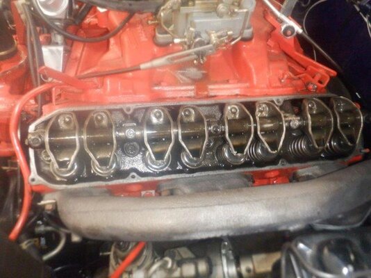

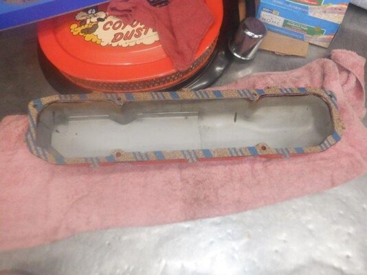

Minor oil leakage from the valve covers. Took them off, re-gasket, repainted them since they were off. Back on. DSCF2411.jpgDSCF2447.jpgDSCF2450.jpgDSCF2456.jpg
