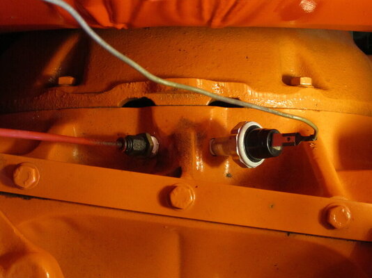

Can you tee off the oil sending unit to run an oil pressure gage and still keep the idiot light working on a 1969 Plymouth roadrunner with a 440.
V.R.D
Oct 27, 2020
501
587
florida
yes but you could remove the other galley plug and plum it from there.
13,696
860
The 440 in my RR had two tapped oil provisions. 1/8" NPT IIRC. Not mine - a pic I grabbed off of the devilweb.

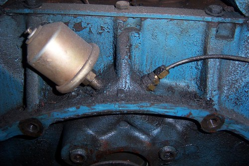

That's how I did mine (383). I didn't know about the other port at the time.
