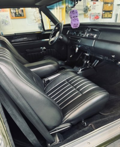

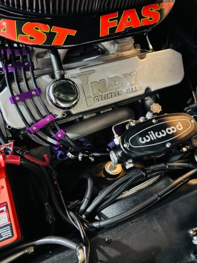

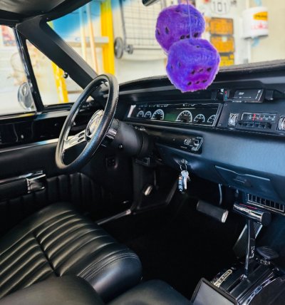

Do you still have the stock steering column? I switched to an iDIDit column that tilts and has emergency flashers on the column. I painted it to exactly match the color and texture of the dash… almost looks stock. I also went with a Bergson steering box. It’s smaller in size and has a tight shorter turn radius. Updated my power brake system with a Hydrotech system (stops on a dime)!!
