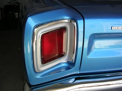

Then mask scuff and paint with light argent paint. Took me about 35 min per side just to mask :yesnod:
