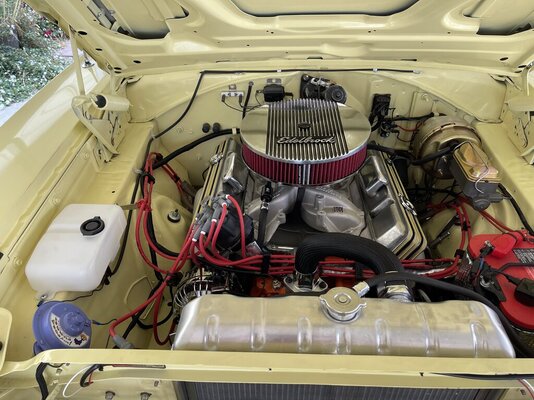

Sep 18, 2022 #1 Mike D Well-Known Member Joined Jan 21, 2021 Messages 45 Reaction score 36 Do I have to run a PCV valve? 440 Eldelbock RPM package. The handles are breathers. And the hose just goes to the front of the carb.
Sep 18, 2022 #2 quikbird Well-Known Member Joined Mar 1, 2014 Messages 3,354 Reaction score 1,142 Location Sarasota, florida Don’t need to but probably should
Sep 19, 2022 #3 V.R.D Well-Known Member Joined Oct 27, 2020 Messages 521 Reaction score 586 Location florida before p.c.v valves the gas / fuel fumes would builds up and if a spark lit the fumes boom went the oil pan so a p.c.v and breather is needed.
Sep 19, 2022 #4 69hemibeep Sponge Bob Square Wheels Joined Sep 10, 2008 Messages 22,351 Reaction score 2,578 Location AZ Desert, Helps keep crankcase pressure down to prevent leaks also
Sep 20, 2022 #5 Ranger Well-Known Member Joined Dec 25, 2014 Messages 1,462 Reaction score 250 Location Woodstock ll Also helps get rid of moisture in the crankcase. I wouldn't be without one.
