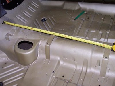

May 20, 2017 #1 Russ69Runner Well-Known Member Joined Aug 4, 2016 Messages 7,940 Reaction score 3,475 Location Lake Wales Fl. Is their a template for mounting the console brackets. So I will know where to weld them on. Russ.
May 20, 2017 #2 Basketcase Keeper of the Green Joined Sep 10, 2008 Messages 14,415 Reaction score 300 easy...the rear bracket goes under the right rear bolt for the drivers seat, then you can figure the rest by setting the console in place.

May 21, 2017 #4 Basketcase Keeper of the Green Joined Sep 10, 2008 Messages 14,415 Reaction score 300 these would be the same auto/4 speed. you can see where the rear bracket is welded onto the seat reinforcement plate.
