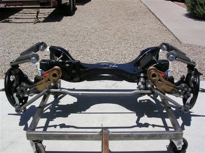

John I would powder coat the k-frame just do to clean up of the crap that lands on it. I did all the black parts and I'm going to drive mine also :thumbsup:

John, I powder coated all my suspension parts. All are black except the LCA and strut rods which are grey. Clean up is fairly easy. Years ago I had my leaf springs done in Spartan Bronze. It is actually a dark grey, almost cast like color. I've also had the pulleys and brackets done. No complaints from me. That stuff is tough.

My vote is for powder coating. I just picked up my K frame and rear end housing this afternoon at the powder coater. 75 bucks to do both parts. Dropped them off last Wednesday and he called and had them done on Friday. They look great, and will for many years to come. Powder coating is the way to go. :beep:
