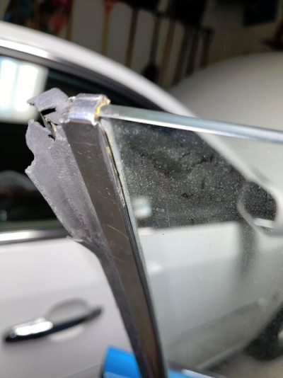

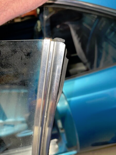

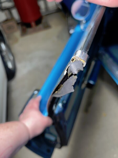

As you can see in the pictures below, the top of the trailing edge of the seal has deteriorated. New set have been ordered. My question is, can I just slide the seal up and out of the chrome track and reinstall the same way or do I have to open the door panel.
724
You should be able to replace them without taking the door apart. Get some spray silicone to aid getting it into the channel easier.

Thank you. That is what I was thinking and hoping to hear. I was afraid that there might be a screw at the bottom holding it in place.
