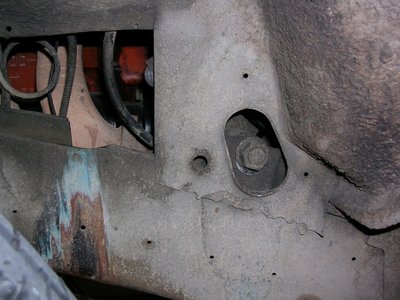

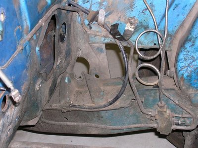

1. I have been lucky in the past slamming them together but if you can get the tools and knowhow to check center I would. 2. I like using the studs but they may inter fear with the headers and need cut or removed. Depending on the headers and car the headers will not come clear of the studs say if you need to pull the heads. Also they go into the water jacket so use sealer on the threads. 3. You will most likely be bending your own fuel and brake lines. 4. No but I can attach some Pics 5. tooooo far away
