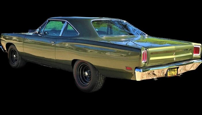

I am getting ready to level the front and rear on my 69 Road Runner (note: it's got the hemi leaf springs - six leaf springs on the driver side and 7 on the passenger side). The passenger front is approximately 1/2 inch too low, and the rear passenger side is also approximately 1/2 inch too low (when it should be higher on that side due to the leaf springs). I believe that by raising the passenger side front, it will both lower the driver side rear and slightly raise the passenger side rear, and hopefully result in a front and rear level (side to side). I am scheduled to take it to the shop that routinely tackles issues with the car (there is always something). They can make the necessary adjustments, move the car around to settle the torsion bars; finalize the height, and finally when done do a frontend alignment.Body Work Finished Ivy Green (1).jpg
