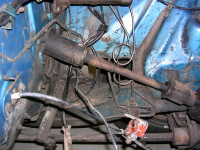

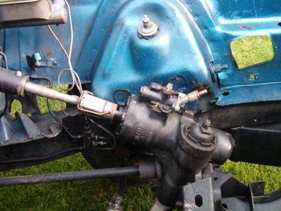

Well I know we had a picture here some where but cant find it. Run my line form the rear to the front. It seems to come up short. Wonder where the distribution block bolt's to the front frame rail. Tried to look through the search block but to no avail. Thanks if someone has a picture. Russ.
Russ there should be two bolt holes on frame rail should be close to the access cover on the lower inner fender
Thank you 69hemiebeep. You know wish I had taken more pic's my self when taking the car apart. But we get into a rush to move forward on trying to get them restored. What happened went through the hole to close to the bell housing not close enough to the frame rail. This dose really help I saved it in my photos. That darn B body book I bought dose not show enough. Wish someone would make a better book for all of us guy's. :thumbsup2::thankyou:
Thank you TOMRR this is a big help buddy. Like I said wish I had taken more pic's. It good to have support from such a good group of guy's. This will help me move forward. Feel's good to be putting part's back on the car now. :thumbsup2::thankyou:
The thing is their is no thread's in that area but the bolt must be self taping so I think. Yes ran the line through the wrong hole first made the line come up short. Move over closer to the frame rail and went through that hole and it is long enough now. Appreciate all the help feel's good to put thing's back on the car now. Working on the dash board now getting it painted and ready to install it into the car. Thanks to all of you for the help could not do it with out this group. Russ. :thumbsup2: :thankyou:
