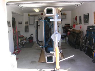

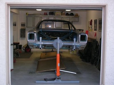

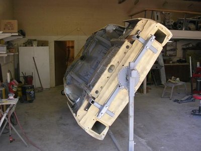

Here is mine attached to the bumper mounts and it was pretty well balanced. I was removing undercoat at the time.

So, is that a piece of angle iron at the rear bumper mounts?

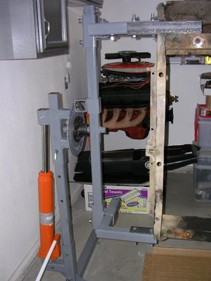

Here is a better look at the rear, the angle is welded to tubing that slipped over the other like a trailer hitch. The last pic is the angle iron to the front frame rail bumper holes

Great! Thanks for the pics. This gets me going in the right direction. This is going to be fun.
22,254
2,500
The first time you turn it is a scary thing. Where I centered it on my car I could turn it all the way around by myself with little effort.
