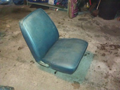

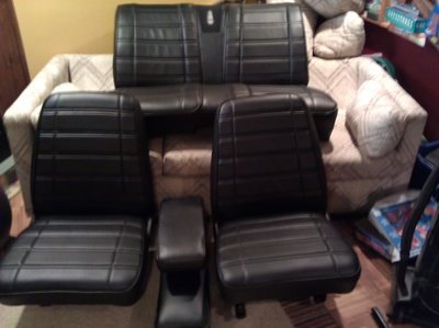

I drove 5 hours each way nonstop to Indianapolis and met up with Droptop (Harold) to get mine. I bought all new materials from Legendary, and they're as good as new! You're right about these cars being expensive. I have about $2k into my seats after it's all said and done...get your wallet out.
Started with this....
Ended up with this....
