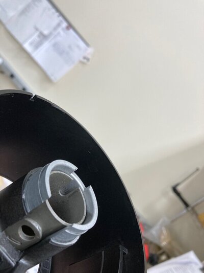

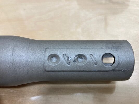

I am rebuilding the steering column on my '70 RR with floor shift and manual steering. The question is which countersink on the shift tube does the shift housing set screw go into? If I push the shift housing as far down as I can on the shift tube, the set screw hits as shown in the first attachment. Just below the first countersink and not anywhere near the second. In that position, the tube sticks up in the shift housing as shown in the second attachment. The housing actually binds on the taper of the shift tube and what limits anymore movement. I cannot go down any further.

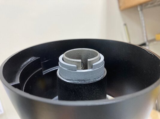

If I then position the housing on the shift tube so that the set screw actually seats in the first countersink, the tube is the height as shown third attachment. The problem here is that you are supposed to bend the tube ears over and lock them on to the housing. Can't do that in the first countersink position as shown.
So what should I do? Seems like the best situation is to position the housing so that it nests in the first countersink. It isn't going anywhere with that. Just afraid that the tube won't be positioned correctly in the column.
