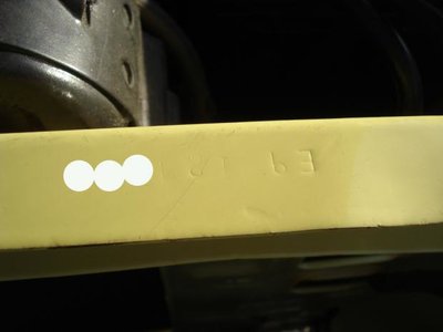

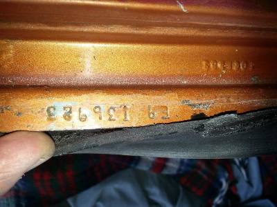

So knowing this it still gets my brain going wondering if the rest of the car is 69 or 68? Is it possible for someone to go to these extremes to make a 68 a 69? Vin sequence is on the radiator support and rear fender rail, but would someone back in the day go to these extremes to make a fake?

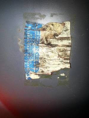

Here is some background as to why one would think maybe this is a 68, When I got the car in 2010 it was missing the front bucket seats, among many trim parts, the rear bumper was from a 68 although the reverse light wires were just dangling there, and the 727 has the 3 prong NSS and is wired right at the starter relay. We know the car was in an accident as the rear passenger 1/4 was replaced, with a factory one from the old San Leandro,Ca parts warehouse. (Sticker still on the inside of the fender :) On the drivers side with the correct sequence # there is chipped away paint around the rear tail light bucket down to metal, the other side is down to the original paint,(now has a 80's earl scheib respray) 383 was not original but correct for the year. 727 seems to be correct so does rear end.

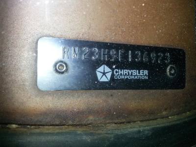

1. the vin decodes with the options that are in the car I.E. buckets, console, AC, light group etc.
2. the vin decodes to the true color of the car inside and out, T5 ext T7 and saddle tan int.

Vin:
RM23H9E136923

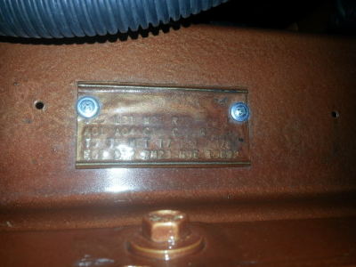

Fender tag:
My 1969 Road Runner Fender Tag Decoded
Decoding of Fender Tag: Botttom to Top, Left to Right
Code Description
E63 383-4 Barrel
D32 H-D A-727 TorqueFlite Trans
RM23 R = Plymouth Road Runner M = Medium 23 = 2 Door Hardtop
H9E H = 383 330HP OR 335HP 1-4BBL 8 CYL 9 = 1969 E = Los Angeles, CA, USA
136923 Sequence Number '136923'
T5 = Paint Code: Fire Bronze Metalic
M6T Trim Grade/Style/Color M = Medium 6 = Vinyl Bucket Seats T = Saddle Tan
T7 Upper Door Frame: Saddle Bronze
131 Date Built: 1 / 31 / 1969
107837 Order Number: 107837
A04 Roof Type OR Color: Basic (Radio) Group
C16 Console w/ Buckets
C55 Bucket Seats
G33 Left Hand Outside Mirror - Manual / Chrome
H51 Single Air /w Heater
T5 Unknown Bronze Fire paint code
L31 Hood / Fender Mount Turn Signal
M21 Roof Drip Rail Moldings
R21 Solid State AM / FM
26 26 in. Radiator
END End of Codes
A01 Light Package
J25 3 Speed Variable Wipers

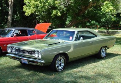

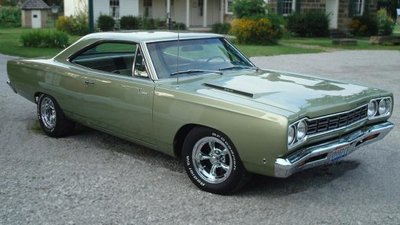

Thanks gunnar. I found most of this out when I bought a '68 road runner as a parts and body panel car for my '69 Lift-Off-Hood road runner and knew I had to restore it and not cut it up into pieces. I had so many 1969 parts and electrical items (including 3-perfect original wire harnesses) that I had collected for the LOH that I soon found out the differences. I have to look for the poor before photo of the '68 road runner and you'll understand how I discovered all of the differences between the '68 and '69. Here's the after '68 road runner:

Radiator support on my LA assembly plant '69 GTX has the last of the VIN stamped on the driver's side TOP not the backside like the Lynch Road and St. Louis B-bodies.................anyone else with a LA car with the VIN there?

Yes that's were mine is, it was under the radiator coolant sticker which got replaced but I shifted it to the right to keep the stamp in view for my own piece of mind. I wish we could get the old records from the L.A.A plant that would be cool.
