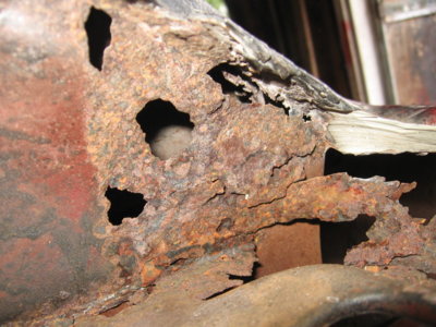

So you went to create thread. Click up load file. Select file. Open the file in the computer select the picture you want click on the picture then hit open. It should start the transfer process. You have to do that for each pic. That is the only thing that take time is going back to my folder and selecting the next pic. Hope this help's. Up load file is on bottom rite now. If I click on it then take's me to select my file would click on my picture file. Find the folder with the pic's open it then select the one I want. Click on it then hit open. IMG_0102 (1).JPG Here is one I just picked out. You will get the hang of it just have to play around a bit.

Yes that photo Icon say your ijmp or something like that wont work. I was darn if I did and darn if I did not. Like the pic's. Glad you got it figured out love those pic's. Russ. :thumbsup2:
