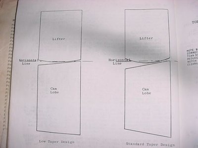

The 69 440 six barrel (I use Plymouth terms because this is a Plymouth site) was the same lift/duration/etc as the 4bbl cam. The difference was the cam was ground with a slight less taper so the lifters didn't wear as fast with the higher spring rates.
None of the current aftermarket supplier specs are going to be a good base for figuring out what cam specs were 50 years ago. They want to stock as few grinds as needed to cover as many engines as they may sell cams for.
Good visual:
