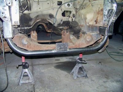

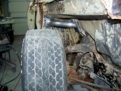

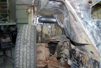

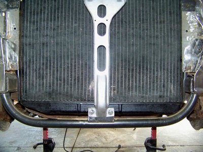

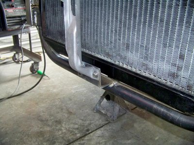

OK, so here's what we decided for suspension improvement and stiffening up the frame. Pictures attached of the lower radiator support and the inner fender braces. Already asked and no clearance issues with the front tires; pictures taken with front end bottomed out.

8) Lower Radiator Support Brace - ordered today. See picture.
9) Inner Fender Braces - ordered today. See picture.

By the way, the pics of the lower radiator support and inner fender braces are not of my car, just examples of the product.
