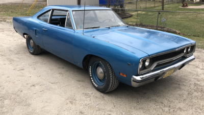

I have a 1970 roadrunner and it has the factory (sleeper) steel wheels. Would like to run the same size tire 15" front and rear without getting into all that fender wheel well rubbing. The current tire in front is a BFG 225-70-15"(redlines). Is it possible to go a a little fatter?
Thanxs in advance!

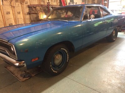

I have 245/60/15 on my car on 7” factory “5th Ave.” wheels. To go wider would’ve needed a wider rim than 7”, according to my tire guy. I wanted a 70 series tire because I like a tall tire on a B body, but the widest they make in a 70 series for a 7” tire is a 235mm. I’ve grown to like the tires I have. I’ve also since lowered the front a bit with this combo, so it looks even better now

My tire guy talked me into the 245/60’s, and I’m glad he did. The only thing I would consider changing would be if I used some 15x8” steelies from an earlier Ramcharger, then I would go back to a 70 series sidewall and a 265. Those rims are tough to find, but my brother has a knack of finding them. If I were you I would consider the Coopers over the BFG, the BFG tires are not what they used to be, they are a harder compound, don’t ride as well, and have a problem of the white letters yellowing or just plain turning brown. Of course, you can mull that one over while you’re riding on the redlines, which is always a very nice look.

I say the 245/60 is the optimal tire size for a 15x7” rim.
