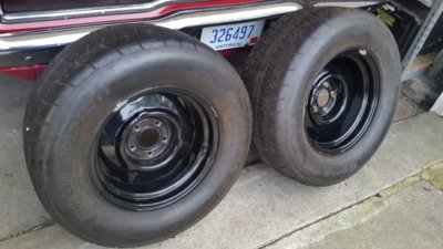

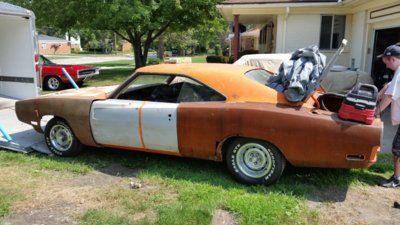

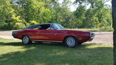

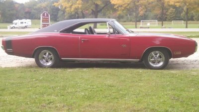

They still fit on my Runner also. Just don't pictures of it with any of the wheel and tire combo's on it.

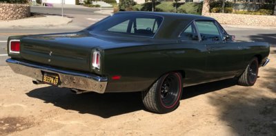

235/60/15 for the front and 275/60/15 on the rear with the stance set as basically stock look really nice. Here is my 69 Road Runner with those size tires on 15 inch black Craggars. The tires are Diamond Back custom made using BFG's They are pricy, but the only way to get this size redline's.
