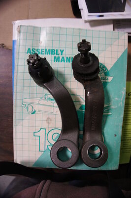

Good suggestion-I did replace the Idler Arm-one thing I learned w/ the replacement parts it that they are dimensionally different from Stock-the new Idler arm was shorter and needed shimmed the steering knuckles were thicker than stock so the castle nut slots weren't deep enough I had to mill the slots deeper. I noticed today that the new Idler Arm put the Center Link tight up against the oil pan on the passenger side-could be my problem. So tight I could not slip a piece of paper between the two. The Pitman arm I got w/ my new steering box has a different angle than stock also-new one is on the left in the photo. I'm going to heat and bend the old Idler arm to see if I can gain some clearance. I'll post a photo tomorrow. I think there is enough adjustment to align things up properly-its just the new parts change the Geometry.DSC01135.JPG
I believe those are cast. May have a problem trying to bend it. Just my 2 cent's. Got all my stuff from summit and it was all the same. If it did not match what I had did not want to use it. One thing throw's every other part off. The only thing that is different is the lower control arm's. The ones I got are adjustable. Matched the adjustment to the old one's on length. Hope it work's out and yes if it cant clear the oil pan then that is your problem. Darn sorry to here that. Good luck and figure you will get it working rite. Know you want to get in it and drive the car. :steering:

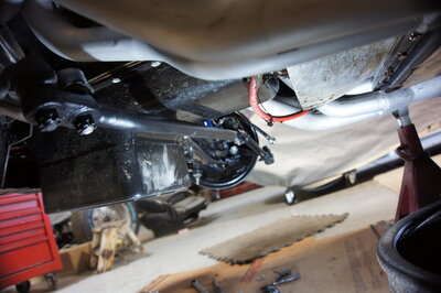

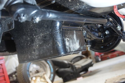

Russ, I'm going to follow your advice and order from Summit. I put the old pitman arm in and Whala clearance issue solved. The new Pitman arm was causing all my problems, never was the torsion bar. It was a New Pitman arm supposed to fit my 68 Runner and match my new steering gear-it had just enough Geometry change to cause problems with the Center Link to bind on the oil pan binding up the steering.
Photo shows bind. Nice thing about these forums is there is enough advice, right, wronDSC01222.JPG DSC01225.JPG g or indifferent to get you looking closer and understanding more. I am very grateful. 2nd photo show clearance under pan with orig pitman arm
You really have to be on your toes with ordering part's. One thing can throw every thing else off. Glad you found the problem. It is hard to help not being their in person to look at what is going on. I feel you are going to be a lot safer with the rite part. That is what worries me ordering off like E bay. Well let is know when you get her in and how it work's. Good luck Larry and happy 4th. :thumbsup2:
